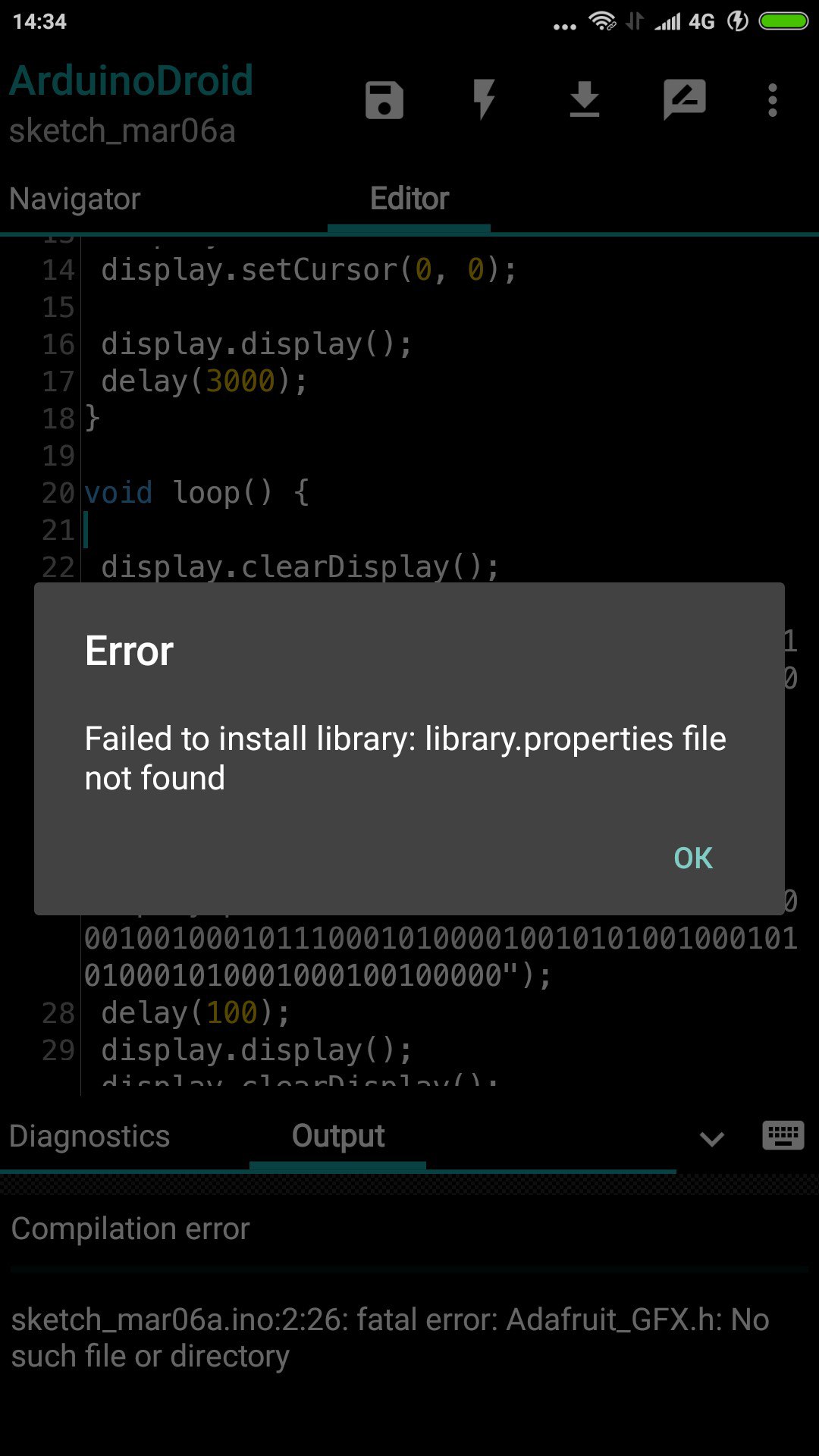

Версия IDE - 1.6.6
библиотеки:
Adafruit_GFX
Adafruit-PCD8544-Nokia-5110-LCD-library-master
LCD5110_Basic
Пытаюсь положить в соовтествующую папку - ошибка в компиляции кода. Пытаюсь инсталлировать библиотеку зип архивом через меню - снова ошибка при компиляции кода. Даже если не обращаться к библиотеке по средствам кода, только подключить ее.
ПРимер ошибки:
Код:
In file included from C:\Users\REB\Documents\Arduino\PROBNI_SKETCH\PROBNI_SKETCH.ino\PROBNI_SKETCH.ino.ino:5:0: D:\PROG\arduino-nightly\libraries\Adafruit/Adafruit_PCD8544.h:36:0: warning: "PCD8544_DISPLAYBLANK" redefined [enabled by default] #define PCD8544_DISPLAYBLANK 0x0 ^ In file included from C:\Users\REB\Documents\Arduino\PROBNI_SKETCH\PROBNI_SKETCH.ino\PROBNI_SKETCH.ino.ino:1:0: C:\Users\REB\Documents\Arduino\libraries\LCD5110_Basic/LCD5110_Basic.h:37:0: note: this is the location of the previous definition #define PCD8544_DISPLAYBLANK 0x00 ^ In file included from C:\Users\REB\Documents\Arduino\PROBNI_SKETCH\PROBNI_SKETCH.ino\PROBNI_SKETCH.ino.ino:5:0: D:\PROG\arduino-nightly\libraries\Adafruit/Adafruit_PCD8544.h:37:0: warning: "PCD8544_DISPLAYNORMAL" redefined [enabled by default] #define PCD8544_DISPLAYNORMAL 0x4 ^ In file included from C:\Users\REB\Documents\Arduino\PROBNI_SKETCH\PROBNI_SKETCH.ino\PROBNI_SKETCH.ino.ino:1:0: C:\Users\REB\Documents\Arduino\libraries\LCD5110_Basic/LCD5110_Basic.h:38:0: note: this is the location of the previous definition #define PCD8544_DISPLAYNORMAL 0x04 ^ In file included from C:\Users\REB\Documents\Arduino\PROBNI_SKETCH\PROBNI_SKETCH.ino\PROBNI_SKETCH.ino.ino:5:0: D:\PROG\arduino-nightly\libraries\Adafruit/Adafruit_PCD8544.h:38:0: warning: "PCD8544_DISPLAYALLON" redefined [enabled by default] #define PCD8544_DISPLAYALLON 0x1 ^ In file included from C:\Users\REB\Documents\Arduino\PROBNI_SKETCH\PROBNI_SKETCH.ino\PROBNI_SKETCH.ino.ino:1:0: C:\Users\REB\Documents\Arduino\libraries\LCD5110_Basic/LCD5110_Basic.h:39:0: note: this is the location of the previous definition #define PCD8544_DISPLAYALLON 0x01 ^ In file included from C:\Users\REB\Documents\Arduino\PROBNI_SKETCH\PROBNI_SKETCH.ino\PROBNI_SKETCH.ino.ino:5:0: D:\PROG\arduino-nightly\libraries\Adafruit/Adafruit_PCD8544.h:39:0: warning: "PCD8544_DISPLAYINVERTED" redefined [enabled by default] #define PCD8544_DISPLAYINVERTED 0x5 ^ In file included from C:\Users\REB\Documents\Arduino\PROBNI_SKETCH\PROBNI_SKETCH.ino\PROBNI_SKETCH.ino.ino:1:0: C:\Users\REB\Documents\Arduino\libraries\LCD5110_Basic/LCD5110_Basic.h:40:0: note: this is the location of the previous definition #define PCD8544_DISPLAYINVERTED 0x05 ^ C:\Users\REB\Documents\Arduino\libraries\LCD5110_Basic\DefaultFonts.c:12:14: error: variable 'SmallFont' must be const in order to be put into read-only section by means of '__attribute__((progmem))' fontdatatype SmallFont[] PROGMEM = ^ C:\Users\REB\Documents\Arduino\libraries\LCD5110_Basic\DefaultFonts.c:117:14: error: variable 'MediumNumbers' must be const in order to be put into read-only section by means of '__attribute__((progmem))' fontdatatype MediumNumbers[] PROGMEM = ^ C:\Users\REB\Documents\Arduino\libraries\LCD5110_Basic\DefaultFonts.c:135:14: error: variable 'BigNumbers' must be const in order to be put into read-only section by means of '__attribute__((progmem))' fontdatatype BigNumbers[] PROGMEM = ^ exit status 1 Ошибка компиляции.
Установил на смартфон, получил конкретную ошибку без лишнего мата:
Gt95aPOI0Gw.jpg [149.88 KiB]
Вопрос, что за "файл свойств" у библиотеки и где его взять? Ну и как вообще бороться с этим глюком?

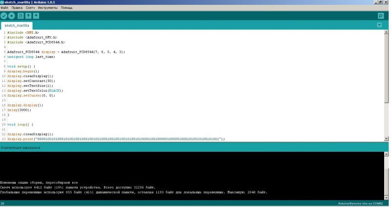

Покажи мне вот так
Спойлер Чтоб я видел свой код, доступные порты, и внизу информацию.
REB
Заголовок сообщения: Re: В IDE отваливаются библиотеки. rкак лечить?
Добавлено: Сб мар 10, 2018 22:36:04
Рейтинг сообщений: 16
Зарегистрирован: Вс сен 20, 2009 00:23:17Сообщений: 1391Откуда: Жидостан
Перезагрузил комп, все получилось. только вместо моей картинки
Код:
0x00, 0x00, 0x00, 0x00, 0x00, 0x40, 0x07, 0xFF, 0xFF, 0xFF, 0xF0, 0x7E, 0x0F, 0x00, 0x00, 0x20, 0xE0, 0x80, 0x00, 0x00, 0x00, 0x10, 0x7F, 0x1F, 0x80, 0x00, 0x70, 0x41, 0xC0, 0x00, 0x00, 0x00, 0x10, 0x61, 0xB8, 0xC0, 0x00, 0x21, 0xF0, 0x80, 0x00, 0x00, 0x00, 0x10, 0x61, 0xB0, 0x40, 0x00, 0x22, 0xE8, 0x80, 0x00, 0x00, 0x00, 0x10, 0x63, 0xB0, 0x00, 0x00, 0x73, 0x19, 0xC0, 0x00, 0x00, 0x00, 0x10, 0x7F, 0x30, 0x00, 0x00, 0xF9, 0xF3, 0xE0, 0x00, 0x00, 0x00, 0x10, 0x7E, 0x30, 0x00, 0x00, 0xF9, 0xF3, 0xE0, 0x00, 0x00, 0x00, 0x10, 0x7F, 0x30, 0x00, 0x00, 0x73, 0xF9, 0xC0, 0x00, 0x00, 0x00, 0x10, 0x61, 0xB0, 0x00, 0x00, 0xF7, 0x1D, 0xE0, 0x00, 0x00, 0x00, 0x10, 0x61, 0xB0, 0x40, 0x01, 0xFE, 0x0F, 0xF0, 0x00, 0x00, 0x00, 0x00, 0x63, 0xB8, 0xC7, 0x07, 0x3C, 0x07, 0x9C, 0x1C, 0x00, 0x00, 0x00, 0x7F, 0x1F, 0x81, 0x8F, 0xFC, 0x07, 0xFE, 0x30, 0x00, 0x00, 0x00, 0x7E, 0x0F, 0x0C, 0xC8, 0xFE, 0x0F, 0xE2, 0x66, 0x00, 0x00, 0x00, 0x00, 0x00, 0x07, 0xE3, 0xFF, 0x1F, 0xF8, 0xFC, 0x00, 0x00, 0x00, 0x00, 0x00, 0x17, 0xF0, 0xCF, 0x1E, 0x61, 0xFD, 0x00, 0x00, 0x00, 0x00, 0x00, 0x0F, 0xF8, 0x0F, 0xBE, 0x03, 0xFE, 0x00, 0x00, 0x00, 0x00, 0x00, 0x03, 0xFC, 0x07, 0xBC, 0x07, 0xF8, 0x00, 0x00, 0x00, 0x00, 0x00, 0x1F, 0xFE, 0x07, 0xFC, 0x0F, 0xFF, 0x00, 0x00, 0x00, 0x00, 0x00, 0x0F, 0xFF, 0x0F, 0xFE, 0x1F, 0xFE, 0x00, 0x00, 0x00, 0x00, 0x00, 0x1F, 0xFE, 0x3F, 0xFF, 0x8F, 0xFF, 0x00, 0x00, 0x00, 0x00, 0x00, 0x07, 0xFC, 0x3F, 0xFF, 0x87, 0xFC, 0x00, 0x00, 0x00, 0x00, 0x00, 0x07, 0xFC, 0x1D, 0x57, 0x07, 0xFC, 0x00, 0x00, 0x00, 0x00, 0x00, 0x0F, 0xFF, 0x3A, 0xAB, 0x9F, 0xFE, 0x00, 0x00, 0x00, 0x00, 0x00, 0x03, 0xFF, 0xFD, 0x17, 0xFF, 0xF8, 0x00, 0x00, 0x00, 0x00, 0x00, 0x07, 0xFF, 0xFA, 0xAB, 0xFF, 0xFC, 0x00, 0x00, 0x00, 0x00, 0x00, 0x03, 0xFF, 0xFD, 0x57, 0xFF, 0xF8, 0x00, 0x00, 0x00, 0x00, 0x00, 0x02, 0xFF, 0xFA, 0xAB, 0xFF, 0xE8, 0x00, 0x00, 0x00, 0x00, 0x00, 0x00, 0xBF, 0xD9, 0x53, 0x7F, 0xA0, 0x00, 0x00, 0x00, 0x00, 0x00, 0x00, 0x2D, 0x9A, 0xAB, 0x36, 0x80, 0x00, 0x00, 0x00, 0x00, 0x00, 0x00, 0x09, 0x1D, 0x57, 0x12, 0x00, 0x00, 0x00, 0x00, 0x00, 0x00, 0x00, 0x00, 0x1E, 0xAF, 0x00, 0x00, 0x00, 0x00, 0x00, 0x00, 0x00, 0x00, 0x00, 0x7F, 0x1F, 0xC0, 0x00, 0x00, 0x00, 0x00, 0x00, 0x00, 0x00, 0x00, 0xFF, 0xFF, 0xE0, 0x00, 0x00, 0x00, 0x00, 0x00, 0x00, 0x00, 0x01, 0xFF, 0xFF, 0xF0, 0x03, 0xF0, 0x7F, 0x80, 0x00, 0x00, 0x00, 0x01, 0xF9, 0xF3, 0xF0, 0x03, 0xF8, 0xFF, 0xC0, 0x80, 0x00, 0x00, 0x00, 0xF0, 0xE1, 0xE0, 0x03, 0x0D, 0x8C, 0x60, 0x80, 0x00, 0x00, 0x20, 0x31, 0xF1, 0x80, 0x83, 0x0D, 0x8C, 0x60, 0x80, 0x00, 0x00, 0x11, 0xF3, 0xF9, 0xF1, 0x03, 0x0D, 0x8C, 0x60, 0x80, 0x00, 0x00, 0x7F, 0xC7, 0xFC, 0x7F, 0xC3, 0x0D, 0x8C, 0x60, 0x80, 0x00, 0x00, 0x10, 0x0F, 0xFE, 0x01, 0x03, 0x1D, 0x9C, 0xE0, 0x80, 0x00, 0x00, 0x20, 0x1B, 0xFB, 0x00, 0x83, 0xF8, 0xFF, 0xC0, 0x80, 0x00, 0x00, 0x00, 0x33, 0x59, 0x80, 0x03, 0xF0, 0x7F, 0x80, 0x80, 0x00, 0x00, 0x00, 0x64, 0x44, 0xC0, 0x03, 0x00, 0x0C, 0x00, 0x80, 0x00, 0x00, 0x00, 0x0E, 0xEE, 0x00, 0x03, 0x00, 0x0C, 0x00, 0x80, 0x00, 0x00, 0x00, 0x04, 0xE4, 0x00, 0x03, 0x00, 0x0C, 0x00, 0x80, 0x00, 0x00, 0x00, 0x00, 0xE0, 0x00, 0x03, 0x00, 0x0C, 0x00, 0xFF, 0xFF, 0xFF, 0xC0, 0x00, 0x40, 0x00, 0x00, 0x00, 0x00, 0x00,
Получается абракадабра.
